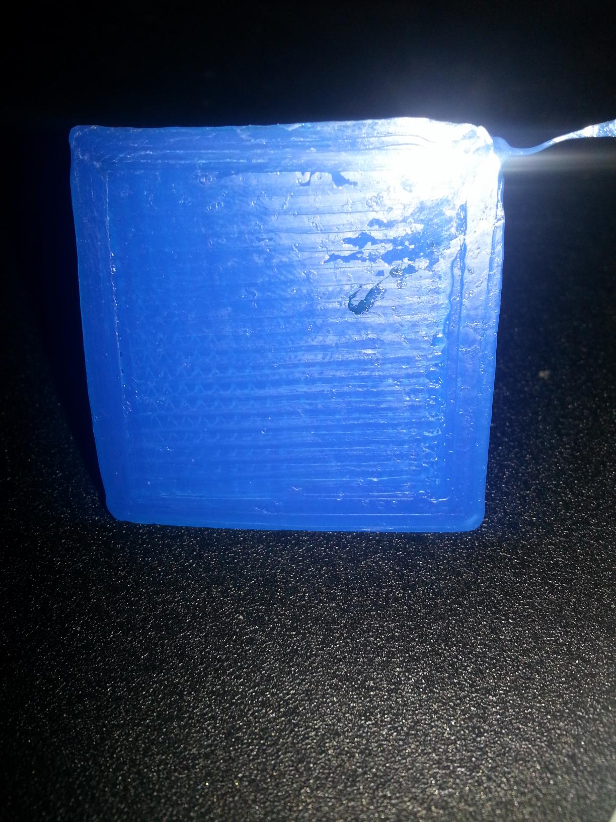

Thought I'd give this a shot. I'm somewhat happy with the outer perimeters but it's a bit blobby on the inner area.It's printed at 198, 60c bed-.20 layer height and 4.5mm retracts.It seems no matter what I do, I can't get pointy areas to work. I have uploaded another failed rocket pic, I stopped this mid print because of the blobs forming at the points.

Do you have fans cooling your print?
Re: Rostock Max Hollow Calibration Pyramid Challenge!
Posted: Sun Dec 21, 2014 5:42 pm
by jram
Hi Xnaron. I have one fan though it doesn't seem to be blowing much. It's larger one that I put on, someone on the forum recommended this. It seems to be spinning really slowly. I have a few smaller fans sitting around with printed shrouds. Can I just tap into the existing wiring to add more?

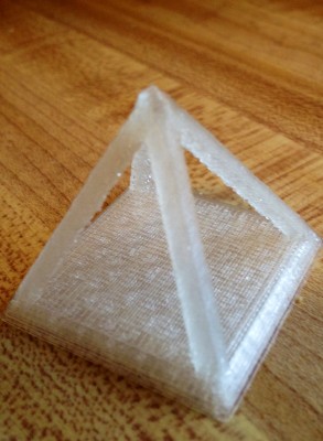

so here is mine... im actually really dissapointed... the close up does make it look worse, but i had a little stringing, and the blob on top...
the outside edges look REALLY good, but the inside are a little off.
wondering where to touch up... i think i need to work on the retraction piece of things.
edit : it did not peel up and deform the bottom right corner, its just sitting awkwardly on a piece of paper :)
