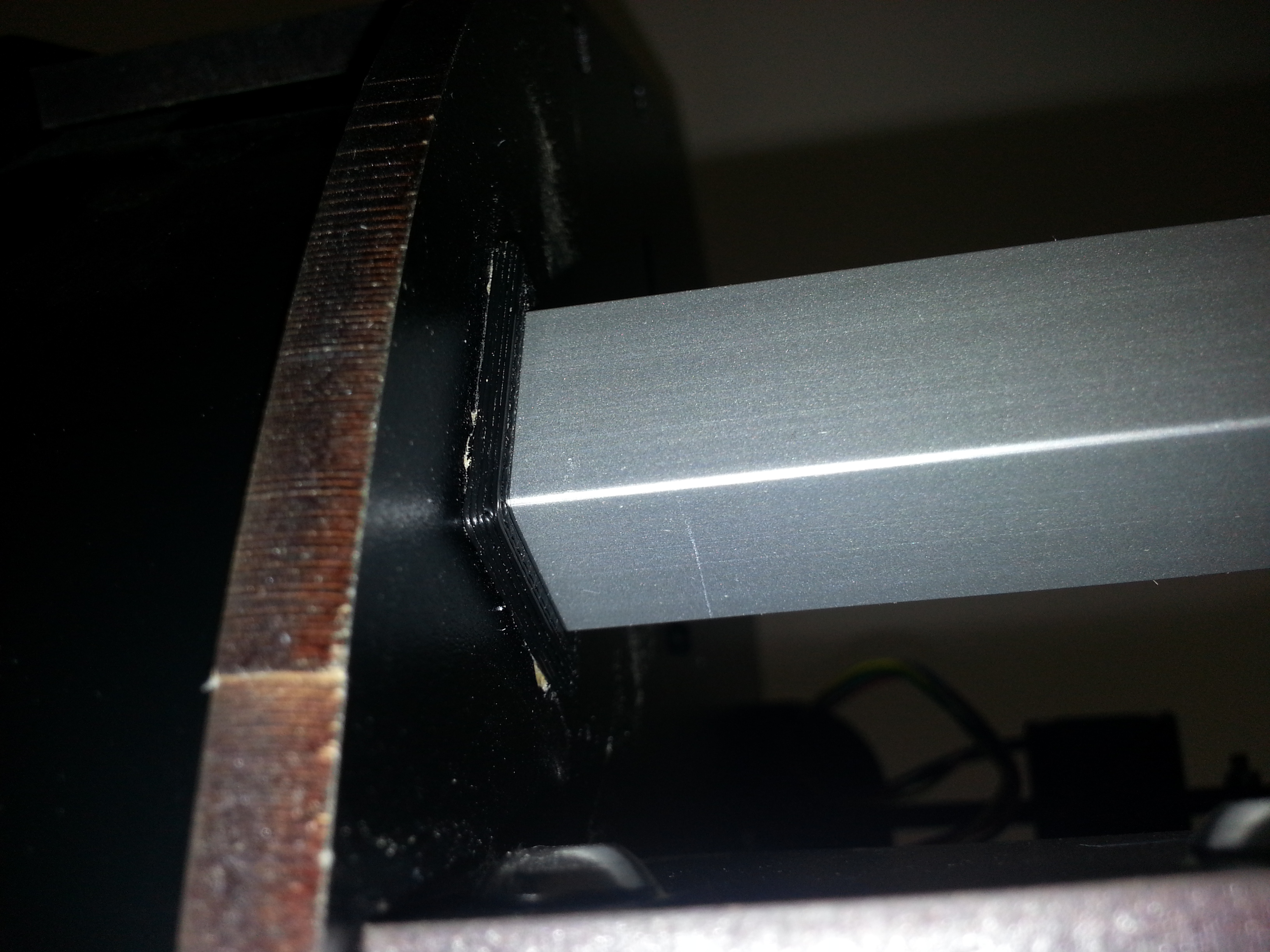

Well I finished installing some extra wiring channels this weekend. I used Tincho85's idea (thanks) and added a couple of things.
Used 3/4" (19mm) square aluminium tubes to give me LOTS of extra space. As I mentioned before I moved them to behind the X and Y towers since the Max V2 seems to have a lot of vent holes beside the Z tower.
I knew I could never cut the holes as nicely as Tincho85 had done so I printed up some square "grommets" to finish around the holes. The bottom ones have a lip on the lower inside to prevent the tube from sliding through. This does away with the need for the cap screw on the top side. The lip also helps protect the wiring from rubbing on the metal tube edge, but I filed aluminium edges with a smooth bevel anyway.
The top grommets were done a little different. They have no inner lip. This allows the tube to slide completely through enough to let it swing into place and seat into the bottom grommet. They do have a lip on the exterior to let them snap into place and stay up.
The upper holes are bit more ragged. I didn't notice how much until I saw the pictures. I may touch-up the edges with some magic-maker. The grommets are only 1mm bigger each side to cover the edges so I probably should have made them a bit bigger.
The insert in the top of the tube is just some more wire protection.
The tubes do clash a bit with the cooling fan.
I could move the fan to the Z tower side but I want to add the other two anyway so this clash will still be an issue. Right now I will just reduce the print diameter. Eventually I will try to design some fan shrouds that move the fans closer to the print head.
Final shot
Thanks Tincho85 and everyone else for your suggestions.
