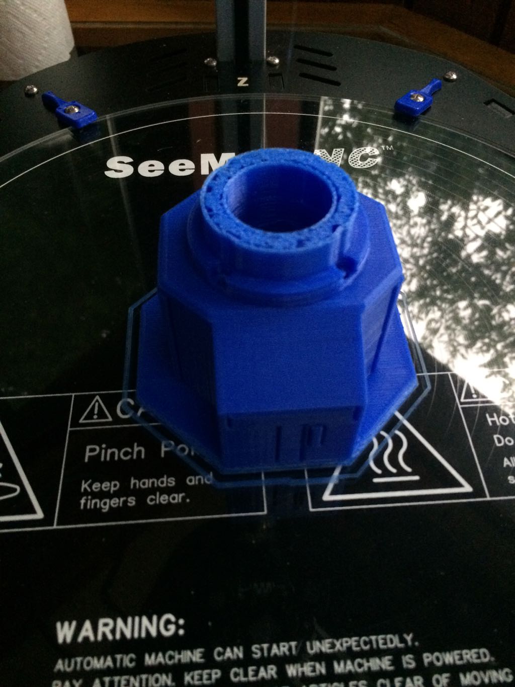

Posted: Mon Oct 03, 2016 9:25 pm
by dmpalmer
Here is my 3DBenchy. MatterControl/MatterSlicer in PLA with all stock parameters.
And here is my third print, part of a CowTech 3D scanner. My H1.1 was never this good, reliable, or easy to use.
