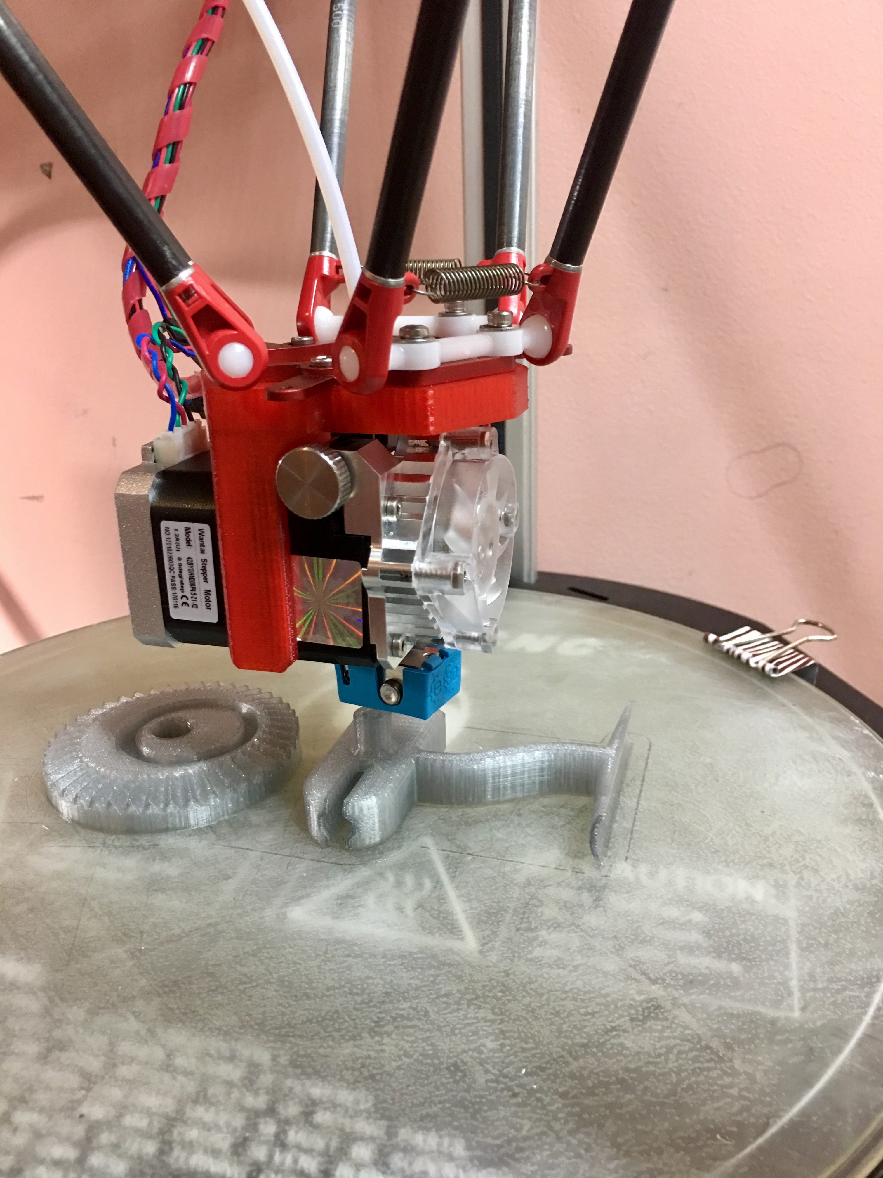

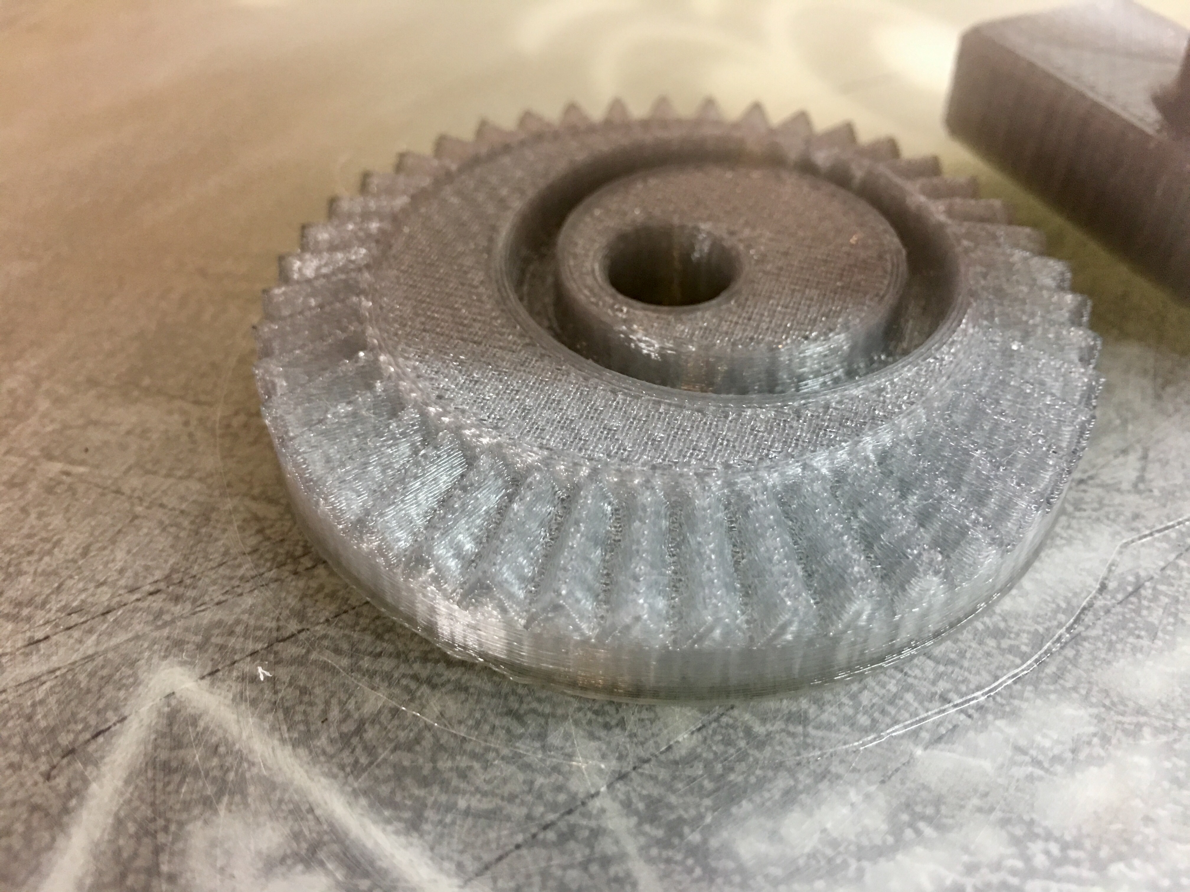

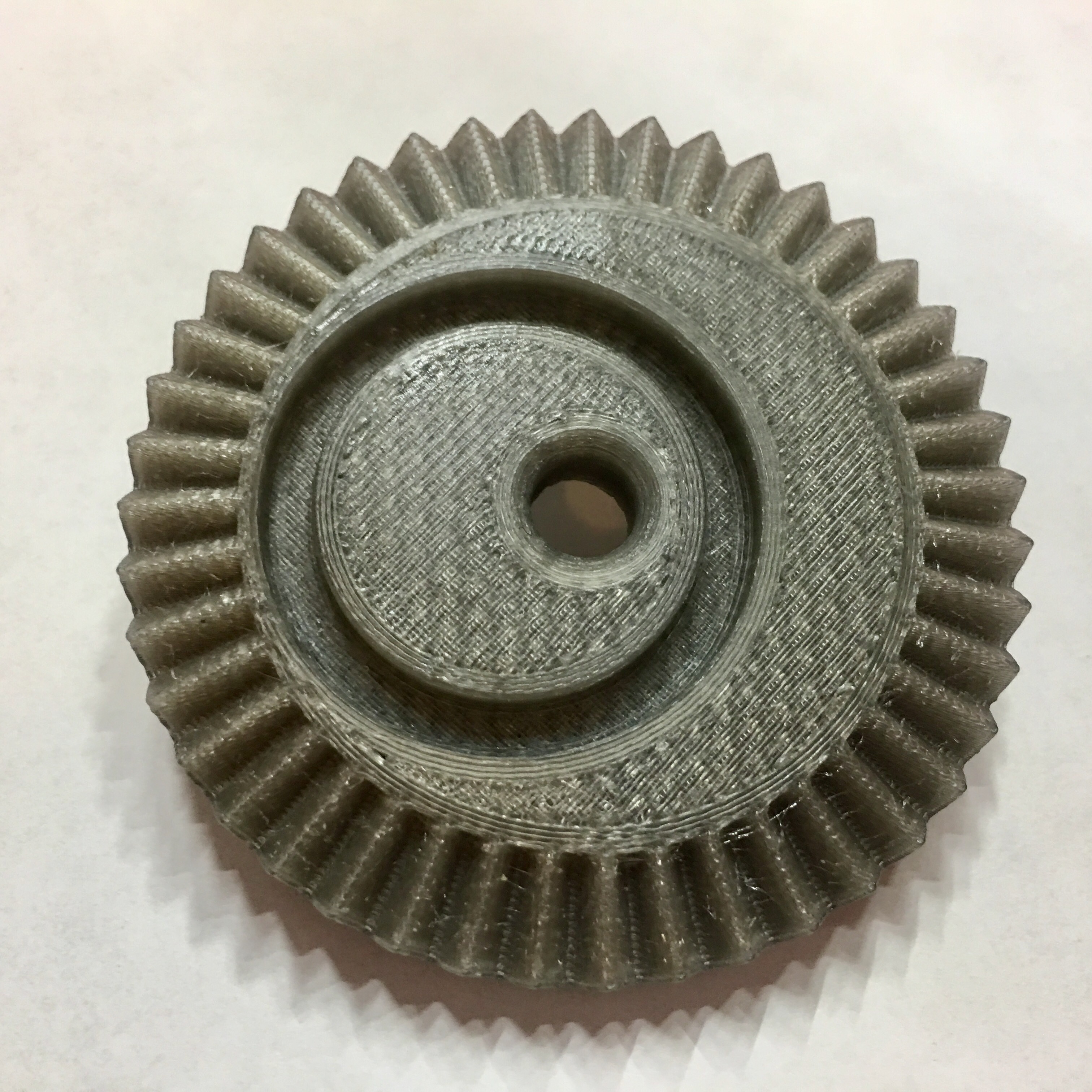

Off topic a bit for direct drive extruders. Since a picture is worth a 1000 words here are 4000 words:
This gear is extremely difficult to print without a LOT of stringing between the gear teeth. There are 1000s of short segments followed by short hops. A challenging part to print cleanly. This photo shows a very good part printed on my Rostock MAX V3 with a 1.8mm ID Bowden and Bondtech QR extruder with a E3D V6 hot end. But as good as it is, you can see the little wisps of filament strings between some the teeth (click the photo for high res view).
This part was printed on the same printer but with the Titan Aero direct drive. Same g-code and same spool of filament. In other words, a very good 1-1 comparison test.
Not a hair on its Chiny-chin-chin (or is it toothy-tooth-tooth?)
