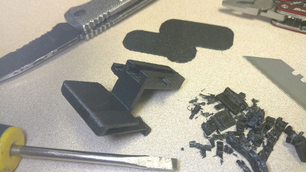

Ok, don't criticize me too much on part clean up, I was rushed some. I'd skip "roof" setting under support in Cura for PETG, this part. It works really good on PLA parts. Atomic Filament.
Here's an 8 pound (4kg) Eris hanging off the small nub feature of the AIWB part. Atomic carbon fiber black PETG. I think this is fairly impressive.
The small nub feature close up. All the weight is hanging on this feature. Could be much better with smaller nozzle.
AIWB small feature 05 nozzle - PETG Atomic Carbon Fiber Black - SeeMeCNC.jpg
Cura screen shot
The printed part on raft:
Cleanup and a few dimensions:
