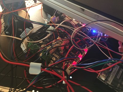

This post turned into a troubleshooting thread for my build so I'll recap what problems were talked about here and the solutions.
  • Grinding noise in Z tower
    wire pins weren't tight in the connector that goes to the duetwifi, take them out -- gently pry out the locking burrs so they properly lock into the connector
  • Stringing
    multiple reasons: ptfe insert in the SE300 was over tightened and kinked, eztruder aluminum exit component shifted when retracting, thermistor possibly unreliable -- all replaced
  • FSR not triggering at printing temperatures
    Calibrate at a lower temp, then set the temp up higher
  • Belts loose
    User error, I was able to tighten them up with the help of a screw driver and some gentle nudging.
OK, this isn't my first rodeo, but I don't see anything in the way of the motors or belts. The movements are very "jagged" or "stuttering". I'm afraid to do the First Probe. It skitted across the bed and then probed a few times but sounded horrible so I emergency stopped.
Also, the Z tower homes down first... I know, check the wires, but they are all correct as per the instructions: Blue, Red, Green, Black.
I had some really close blue/green wires, but I quadruple checked in good lighting--I'll check again after posting.
Anyone else get this problem and know what I did wrong?
*edit, here's a photo of the duet in case it helps.
And, a youtube upload (never did one before...)
https://youtu.be/wivW865AECE
messy wires as I reconnect and attempt to debug.
*edit2, I forgot to mention that I did download the latest config.zip and upload it... I've got the first probe macro.
*edit3, I got it to accept a homing so I could test moving again. The Z axis alternates from going in one direction then the other every time I ask it to move in the same direction.

How does it go when you home all the axes? Is it just the Z axis you're having a problem with?

Just added a video and a picture.
I've only tried homing all axes at the same time. I tried moving 100mm up and down and it sounds horrible too.

I suggest you test the tower motors individually as described at https://duet3d.com/wiki/Configuring_Rep ... dividually.

First thing I noticed in your video... the USB cable is connected to the Artemis.
Is it also connected to the computer? If so, it should not be... that caused grief for me when doing the first probe... it kept timing out. So remove the USB cable entirely once in Duet, then refresh the Duet web page.
I don't know if this is what is affecting your build, but it was worth mentioning.

Thanks for the tip, I thought about that and disconnected from pronterface at least. I’ll try again with out it at all and test the towers like dc42 said.

Thanks, It's only the Z that is noisy and alternating. I checked the pins with a multimeter and red/blue and black/green are the two pairs.
It's the motor and not the board thankfully. I swapped the motors with another axis and it's the same motor that is noisy.
Have a resource that can help me further trouble shoot the motor?
Re: First homing: horrible grinding sounds
Posted: Sat Dec 30, 2017 1:51 pm
by adarcher
OK, I think I solved it. The spring side of the red pin wasn't super springy so the contact was not consistent. I pulled it out, bent it out a bit and now it's good.
It's now taking it's time doing the first probe... I'll post again if I get a first print :)
Thanks for all the help!

[img]https://i.imgur.com/3XbY51j.png[/img]
