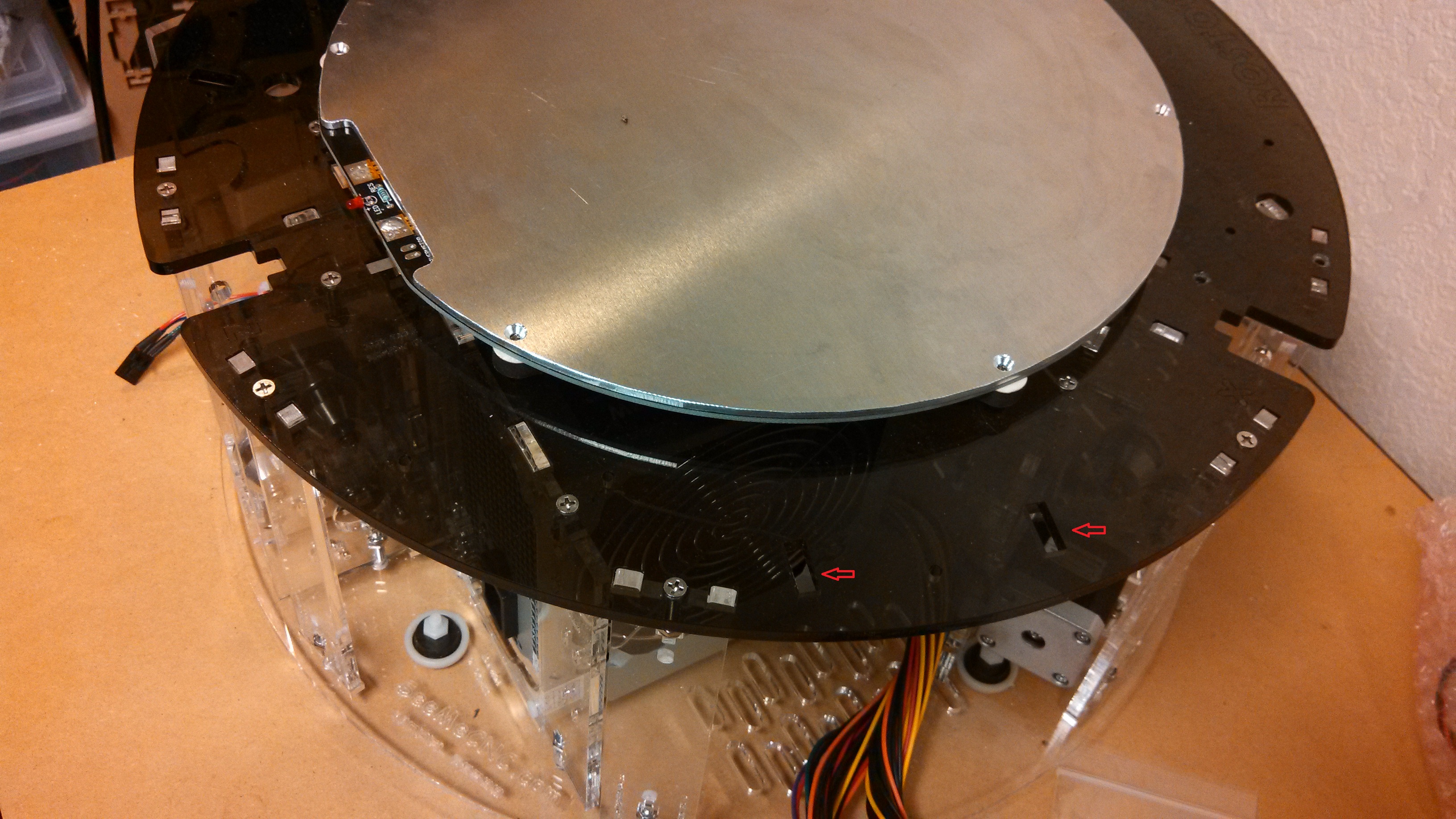

Idlers installed, motors w/connectors mounted, and base-top loosely installed for verification. I couldn't find any visual evidence, but I assumed the large holes for the motor mounts were there to allow the motors to be mounted flush against the P/N 68364 pieces (else it would seem easy to have a tilted motor). They were all slightly undersized and required a fair amount of shaving/filing. Much more then I would have expected actually.
Nearly all of these motor mounts developed small cracks over the past few days at the screw holes even though these were only tightened to a detectable resistance point. Possibly from moving the base around during the build - it didn't happen during the motor mount. One could probably make a case to have an acrylic & melamine kit where all of the parts that get real stress are made of melamine.
You might be able to make out the LCD door in the picture (it is labeled "Support Panel" in this kit, whereas the "Electronics Mount" is blank - no mounting holes). I spent a lot of time looking a the Geneb's excellent build UM to try and put the doors in the right place. Despite the advice therein, I managed to get them wrong which I discovered after tightening all the screws/etc. I would advise not being in a hurry to tighten the top since it's useful to remove it to mount the bed. You will probably want to do the idlers and the motors before attaching the top and doors as well (as Geneb's UM and other build threads advise).
Speaking of the top, one screw hole near the power supply didn't line up quite right. I had to shave the square shaft leading to the nylon nut to avoid stressing the top plate.
And for reference on doors & extruders, these slots are where the extruder brackets can go. So, if you plan on having two or more extruder setups, keep these in mind. A simple look at these slots will tell you where you don't want the LCD (assuming you want to use it).
And from those pictures you can see that I machined up an aluminum plate for the bed. The Onyx went together easily enough and again, some great instructions in Official Docs forum. I would have done well to re-read them as I was assembling but no major mistakes.
The UM mentions how the holes in the base top for the bed and spacer have notches for the t-nuts to catch in. Well, one of the holes did but none of the others did. For that one hole, things went perfectly. The rest not so well - those don't bite into smooth acrylic very well (or at all if you prefer). Attempts at manually adding notches also didn't work out too well. Something to plan for...

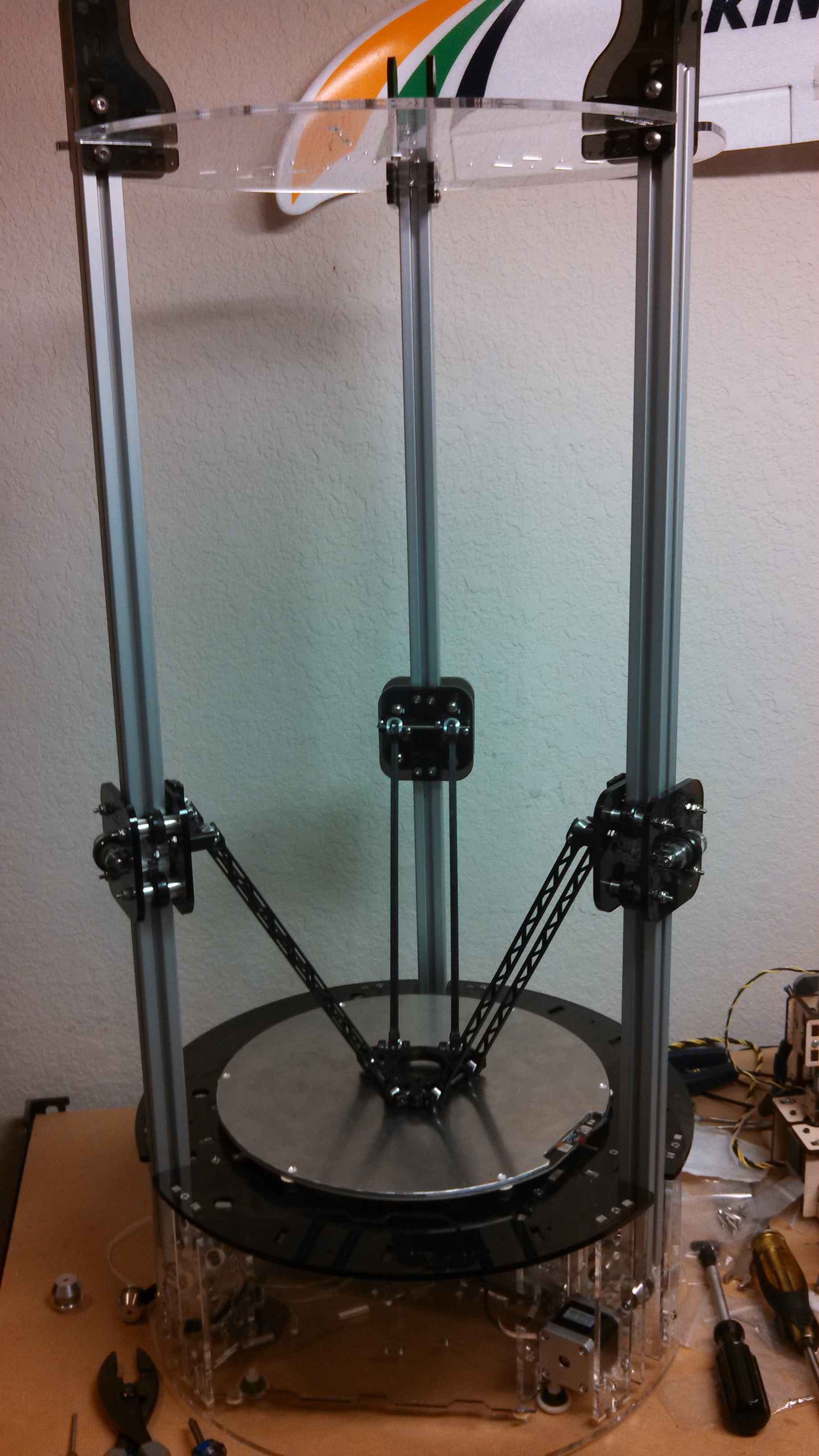

The build moved steadily forward over the past weekend. Adding rails:
Carriages:
Platform and struts:
Belts:
Extruder, hot-end, and "it's alive!":
I used some braided cable sleeves to keep things tidy (http://www.amazon.com/gp/product/B004UH ... UTF8&psc=1) and routed all the hot-end cabling with the filament sleeve.

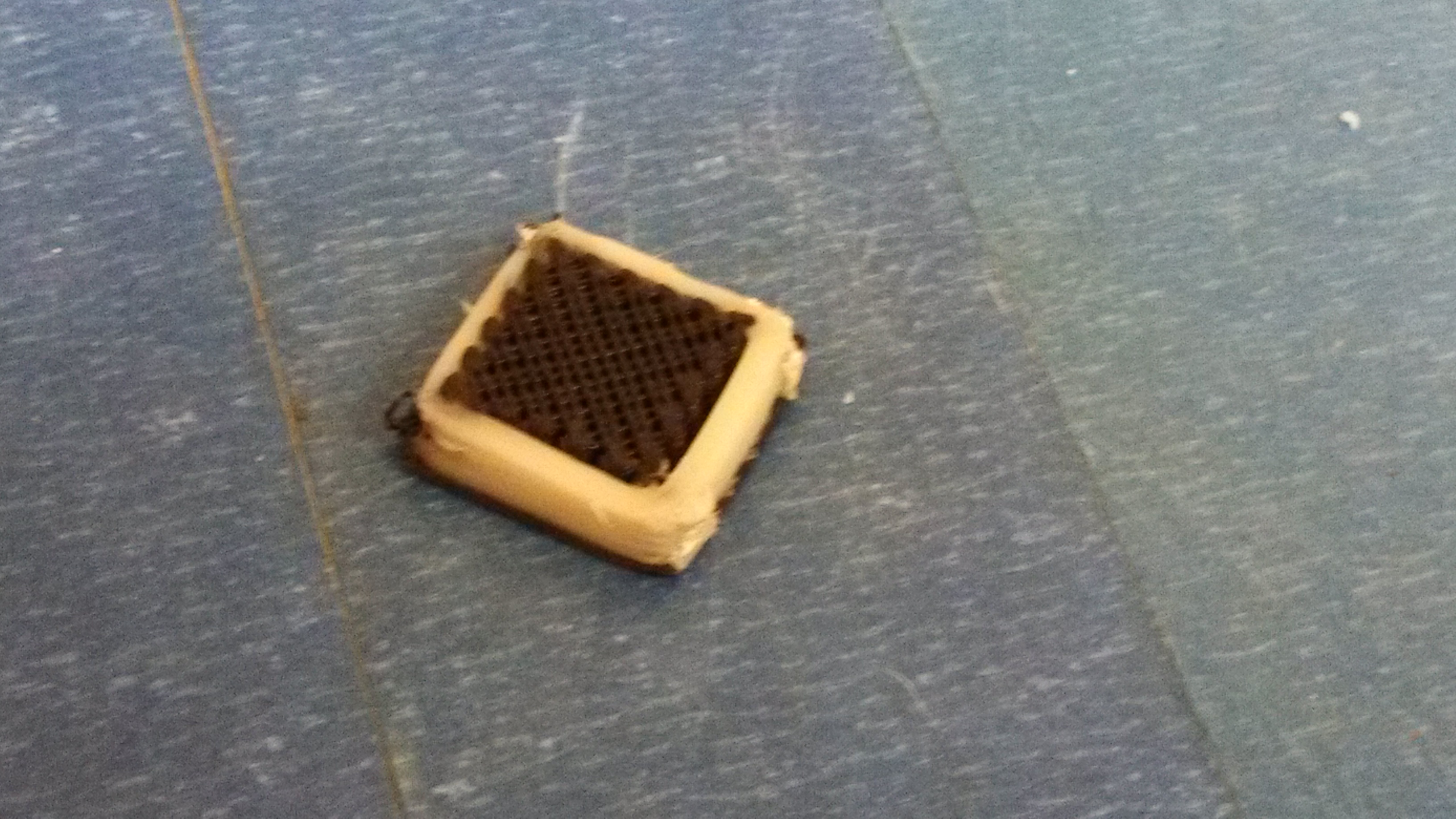

And the really early 2-extruder results are:
As the quality of the print indicates, a lot left to do. This was infill with one extruder and perimeters with the other. I had no ooze prevention enabled and with both nozzles oozing, it was pretty messy. Since this print, I have been playing a bit with the USE_OPS and OPS_MODE settings in Repetier and the results look pretty promising so far.

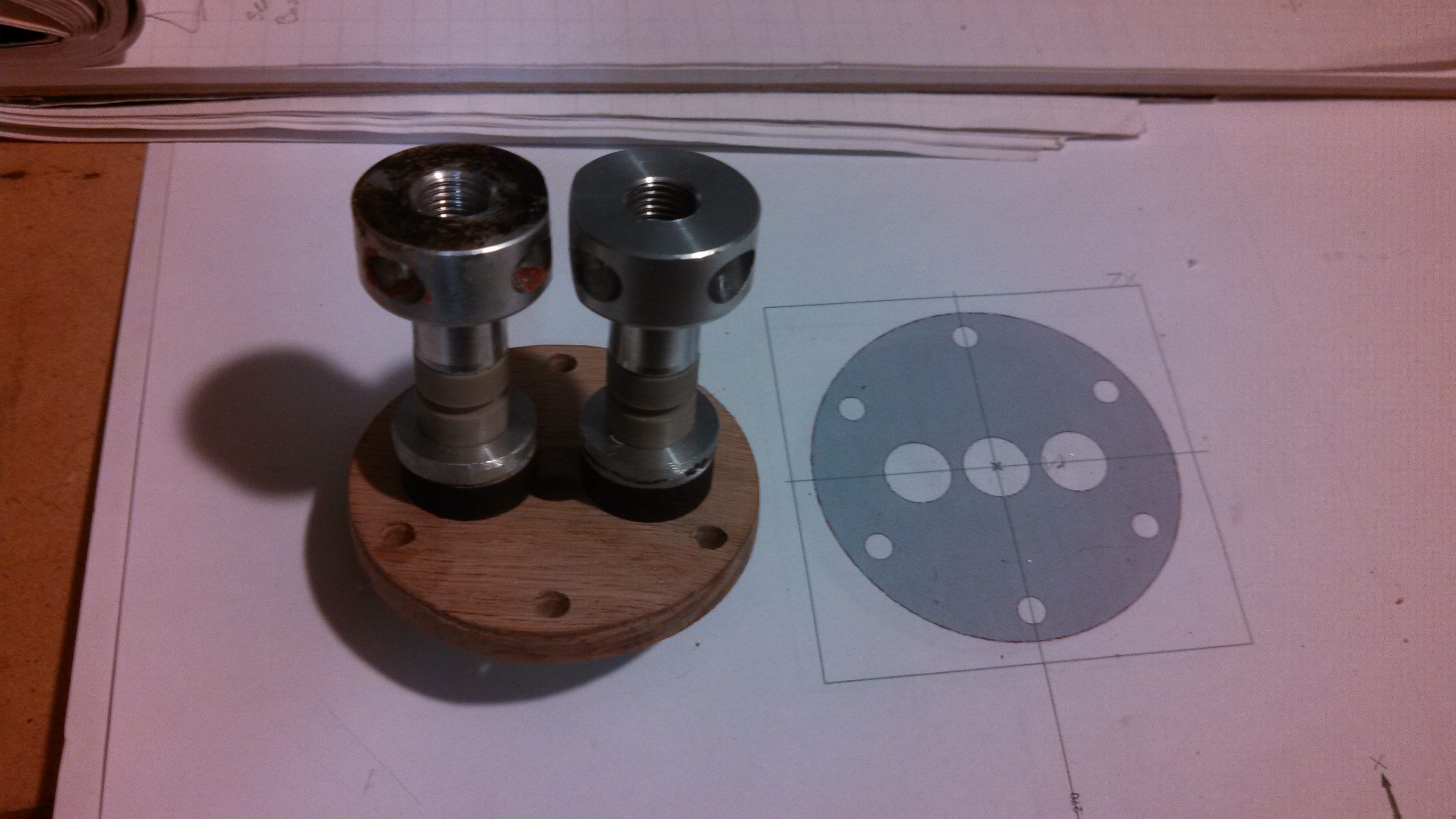

Why the '1-or-2' adapter you might be wondering.. Here's a picture of the stock hot end adapter with two extruders.
I had no luck finding a configuration that didn't touch. The spacing just seems wrong for more than one extruder. Maybe I was missing something? But it was easy to CAD up a replacement:
