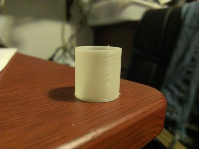

Curiously, I've been successful at printing hollow cylindrical test objects with no shifting at all.
- hollow cylinder
This was printed at 10mm/s, single wall 0.2 layer height

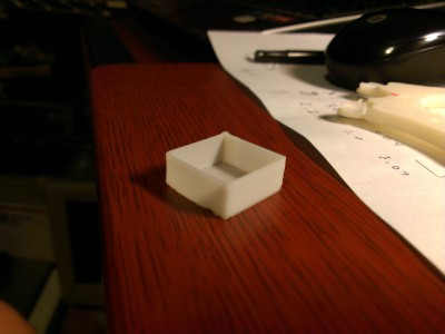

I mentioned earlier that hollow cubes printed ok for me too:
- 20mm cube

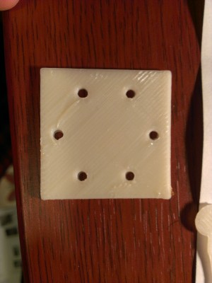

I made a test object that's a 40mm square, with an array of holes to test dimensional accuracy on the printer, but it prints out skewed.
- test square
- test square2
You can see the holes between layers don't exactly line up

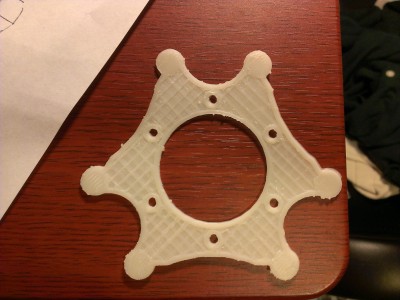

I've designed a hot end platform with divots for steel balls for use with my experimental magnetic joints. Printing that has yet to be successful.
- Platform_killed
This print I killed part way through when I saw the layers shifting. The holes don't line up.

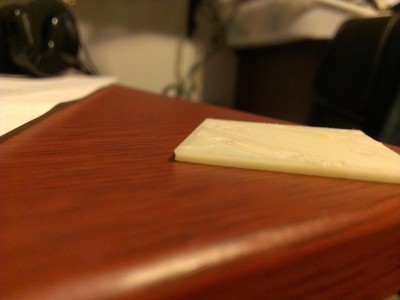

- platform side
This is another attempt. Looking at it from the side you can see the layers don't line up.

Is the other side of that platform side print skewed inward? If so the orientation of the skewing will tell you which axis has the issue. Maybe try a three pointed star and orient it to match the tower pattern.
