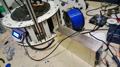

by msdevstep
Just wanted to say thank you to everyone that responded.
Cambo3d and Eagle, thanks for the recommendation on the power supply. I'm currently using it with no problems thus far. The one thing I will say about it though is it's loud. The fan stays on full blast the whole time. It doesn't bug me that much, but I just wanted to mention it for anyone else that may be needing a power supply.

Re: Source of 24 volt 20+ amp Power Supply
Posted: Thu Jul 11, 2013 10:32 pm
by cambo3d
I run two printers off this same power supply, so it serves me well, yes it is loud though.
