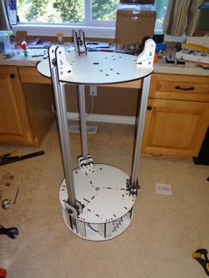

We were able to get everything put together for the base, the arms, the top and the idler mounts. Made a few mistakes along the way, the worst of which was stripping the threads for one of the set screws on one of the gears attached to the motors. I'm not exactly sure how I did it, but I think I must have had the screw cross-threaded when I started putting it in :P I thought it was a little tight to turn but assumed it was due to the thread locker -- apparently it wasn't :( Anyone think that will be a problem (i.e. are *both* set of set screws needed or will the one that contacts the flat side of the motor shaft be sufficient)?
Here's a picture of the assembled base, extrusions and top:
[img]http://myplace.frontier.com/~dean.macri ... stock3.jpg[/img]
We've moved on to assembling the bearings. I sanded the u-joint slots and felt I had them good for the bearings being able to spin freely. However, after mounting them to the melanine, only one of 6 still spin freely. The good news is I can sand some more :D

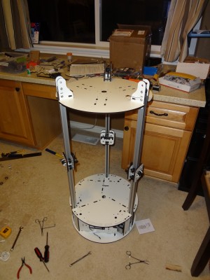

Finally got a chance to do some more building today! My son and I got the cheapskates installed. Fortunately for me, as I was scratching my head trying to figure out why we only had one 1.75" #6 screw left for the axel supports, he put it through one of the supports and realized that 1.75" was too short. So typo in the instruction manual (Gene B, if you're reading this, it's on page 66 -- the screw for the axels should be 2").
Cheapskates installed
Once we got those on and were pretty comfortable that they were moving smoothly, my son had to go to bed :-(
So I installed the belts:
Belt's installed
Belt's installed

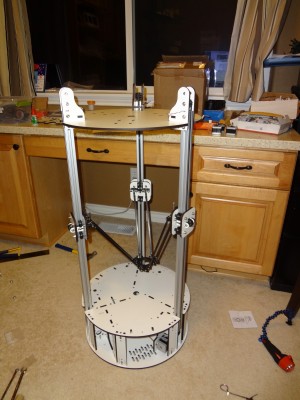

And then I installed the arms and the effector platform. Yes, I cheated from having to do all that sanding by using the Trick Laser arms I ordered :-) I was actually planning on using the SeeMeCNC arms initially and then upgrading at a later date. I had even sanded the U-joints on the Cheapskates to have the universal joints spin freely. But when it was time to do the effector platform and I realized how much sanding I'd have to do (plus it was already late ;-)), I just decided to go straight to the Trick Laser arms. Man, they're nice! Installation was a breeze (I had bought the pre-assembled arms).
Here's where I'm at today:
Arms and effector platform installed
One more note on the assembly manual (I'll write these up for Gene separately when I'm finished in case he's not reading here): the manual on pages 79 and 80 refer to the sheet metal screws for assembling the platform as being 1/2". I'm 99% certain they're 1/4" -- at least that's what came in my kit and what I used :D
Hopefully we'll get the extruder (and more!) assembled tomorrow!
