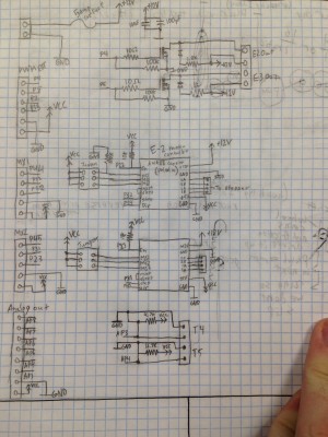

I'm having issues, the schematics on the RepRap wiki do not match the pin assignments defined on the development page. The analog extension output 4 says it's fan 2 on schematics, but on pin assignments it says it is just output 4, not assigned to FAN 2. Also, the pin assignments for all of the motor extensions contradict with the schematic drawing.
http://reprap.org/mediawiki/images/7/75 ... ematic.png
http://reprap.org/wiki/Rambo_development

Nylocke wrote:I'm having issues, the schematics on the RepRap wiki do not match the pin assignments defined on the development page. The analog extension output 4 says it's fan 2 on schematics, but on pin assignments it says it is just output 4, not assigned to FAN 2. Also, the pin assignments for all of the motor extensions contradict with the schematic drawing.
Why do you say the pin assignments for the motor extensions contradict with the schematic? For Motor extension 1 (X20 in the schematics), Pin 5 is connected to PL5, Pin 4 is connected to PC5 and Pin 3 is connected to PA0. Then in the pin assignments I see these:
40 PL5 ( OC5C ) Digital pin 44 (PWM) MX1-5 Direction
58 PC5 ( A13 ) Digital pin 32 MX1-4 Step
78 PA0 ( AD0 ) Digital pin 22 MX1-3 Enable
Similarly, Motor extension 2 has 5 to PL4, 4 to PC6 and 3 to PA1 in the schematic. Then these pin assignments in the dev page:
39 PL4 ( OC5B ) Digital pin 45 (PWM) MX2-5 Direction
59 PC6 ( A14 ) Digital pin 31 MX2-4 Step
77 PA1 ( AD1 ) Digital pin 23 Y Max, MX2-3 Enable
Those seem consistent to me -- what am I missing?. Obviously there's a problem with the motor extension pins also being used for the MAX end stops :-P

Gah you're right, I was over analyzing or something, doh. The pin assignments will have to be reassigned to the min stops being the max stops in the firmware, simple fix :) this mod will require some heavy modifications to firmware... Also some test subjects :P

Nylocke wrote:Gah you're right, I was over analyzing or something, doh. The pin assignments will have to be reassigned to the min stops being the max stops in the firmware, simple fix :) this mod will require some heavy modifications to firmware... Also some test subjects :P
Okay, cool! I thought perhaps I didn't understand the diagrams :-P Good thought on moving the min stops to the max stops. That's an easy enough FW change to make and test out before the added development.
Also, are you planning on micro-stepping the extra 2 extruders? I guess you'll need to use 4 of the analog extension pins for those and the remaining analog extension pin for the extra thermistor.

I'm using pololus so they just are using jumpers. I know about the analog extension, 2 more analogs for the thermistor. Since this mod is meant for the MAX, and most printers don't use min and max endstops anymore, I think that the change will be fine.

alright here is what i got for running the extruder motors using just 1 motor driver on the rambo.
using shift registers the amount of extruders is endless. but would require 2 digital outputs from RAMBo to set them up. This image is just a single 8 bit shift and it runs 2 steppers.
input into register 11110000 and you would enable one stepper, or input 000011111 and it would enable control over the other stepper.
my thought process would be to save as many pins as possible... i cant foresee a reason to ever run multiple extruders at the same time so this should work.
separate heaters and thermisters would still need to be configured.
[img]https://lh6.googleusercontent.com/-H-Gq ... Slide1.PNG[/img]

I just have it set up to use 3 pins per controller. If you wanna experiment with the shift registering stuff then you can yourself, the purpose of this mod is to add 2 extra extruders and make it simple enough for a intermediate hacker to put it together. I'm just going to fuse a new 12v input, 5 amps sound good?

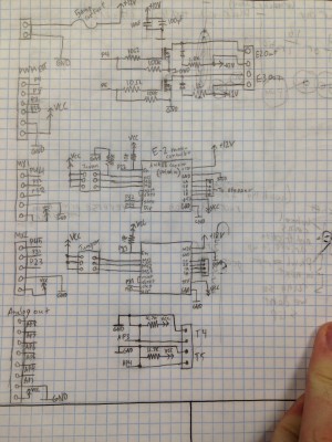

I have a roughly sketched version of the schematic in my notebook, Ill attach it. Its mainly based on RAMPS electronics, mainly because RAMPS seemed the most accessible to hackers, and a bit easier to understand for me (mainly because of the blurry low quality schematic on the RepRap wiki of RAMBo)
I don't really have the money or resources to test this out, nor do I have a MAX or RAMBo based printer to use it with, but if someone could actually make one to verify things work, modify the firmware to make it work, that would be awesome to see, or if anyone has any critiques on it, I can modify it, or best yet, if someone could make a more official looking schematic or even a trace pattern for people to make their own boards for this (rather than hacking together something on a breadboard) that would be AWESOME. Hopefully this will be of help to you guys. All of the ports on the side are the outputs from the RAMBo that you will need to use (except the 12V power, which would need to be a terminal on the board) and connect to the board. The number assigned to them are the pin numbers in Arduino, anything with a P## is a digital pin, and anything with an AP## is an analog pin.

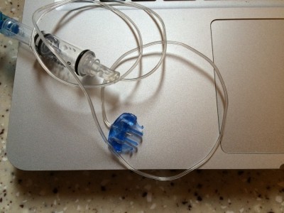

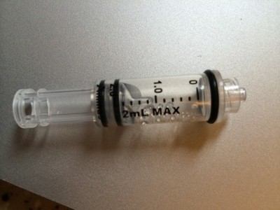

Insulin cartridge
Insulin cartridge
The length of the "2ml" of the cartridge is 20mm. So every mm would deliver .1 ml of liquid.
Then, the cartridge is connected with a Luer lock to a tubing with a plug at the end. It looks like this:
Insulin cartridge with tubing
The outside diameter of that needle at the end is about 0.5mm. My plan is to use an M3 screw with 0.5mm pitch threads and a 1.8 degree stepper motor (that's what the RMax currently uses). Without any micro-stepping, that would deliver 0.00025 ml of liquid per step (unless I've done my calculations incorrectly :-D). I'm hoping that by hooking up several of these, I can make something that can put small drops of liquid along the perimeter of a layer, blending for different colors.
