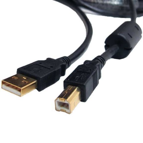

The realtime view can mess you up but so can the area where you can move the effector by hand. It reads out the coordinate on all axes which means that the board has to send that data over serial, allowing it to compete with data that's actually important. Try switching to the G-code view.
You can also try some different baud rates. I run on 115200 and it doesn't pause, unless my computer is grinding on something. Others swear up and down it has to be 250000 because of the ATMega's clock speed. Try both of those speeds if you can. (If you run Linux 250000 can be challenging. I never figured it out.)
Another idea would be to get a USB cable with a ferrite bead, which is visible as a round plastic casing near the square end of the cable:
Your USB cable probably has one of these already, but make sure. There is a lot of EM activity from a functioning Rostock, especially the heated bed when it's maintaining temperature by rapidly switching on and off. If you put a neodymium magnet on the Onyx when it's up to temperature, it will dance around!

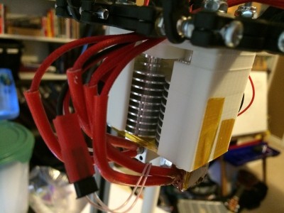

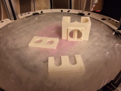

I got a second E3D for Christmas and have just got it set up to print. I've printed the bottom few layers of a calibration cube using ABS for perimeters and HIPS for infill. I only printed a few layers because I was extruding too much on tool changes.
I designed my own mount for it which seems to be working well so far. Here are a couple pictures:
Mount parts
Mount parts
Attached parts
Attached parts
I'll post the FreeCAD file and .stl files when I get to my computer if anyone's interested.

dpmacri, you haven't experienced any cooling problems with replacing the E3D coolers with that one fan in the rear?

Eaglezsoar wrote:dpmacri, you haven't experienced any cooling problems with replacing the E3D coolers with that one fan in the rear?
No, I haven't -- but I haven't used the printer much since the modification. I took some thermocouple measurements with both hot-ends heated to about 240C and the temperature on the lower fin of the E3D was only like 70C I think. I'll take another measurement as soon as the print I'm doing finishes.

I just did some measurements with both hot-ends set to 250c. The hottest I was able to get my thermocouple was 40c on the underside of one of the cooling fins. So I have no plans to redesign this. However, since you've given me so much support on these forums, if there's a specific modification you'd like, Eaglezsoar, I'll happily do it for you.

If that's all the temperature is on the lower fins then it doesn't need redesigned but I appreciate your willingness to do so and your kind words. I'm going to print it out and keep it until I am ready to use it on one of my RMAXs.
