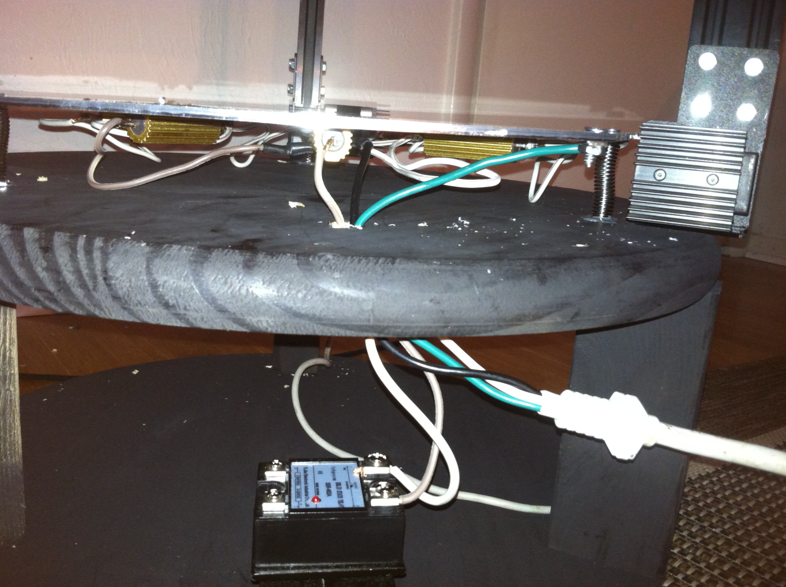

Home depot parts again
just a little perspective
Basic layout of the resistors
resistor closeup
Wired up in series
I refer to this site for the resistor part of the build
http://eclecti.cc/hardware/ac-powered-h ... for-reprap

I'm going to put a gfi circuit on that line, and ground the plate to prevent shorts. I was wondering what you guys would use to insulate the bottom side of the hot plate? I was thinking truck bed liner?
Re: XL delta build
Posted: Tue Feb 04, 2014 1:26 pm
by Eaglezsoar
calibur2121 wrote:I'm going to put a gfi circuit on that line, and ground the plate to prevent shorts. I was wondering what you guys would use to insulate the bottom side of the hot plate? I was thinking truck bed liner?
Bed liner would probably melt, common fiberglass insulation has a melting point of 1300 degrees and that is what I would probably use.

I received the eflector kit in the mail, a dab of JB weld
And i cut the base plate to fit in between the pillars
And then JB welded the resistors to the bottom of the plate.
a couple pics of the SSR

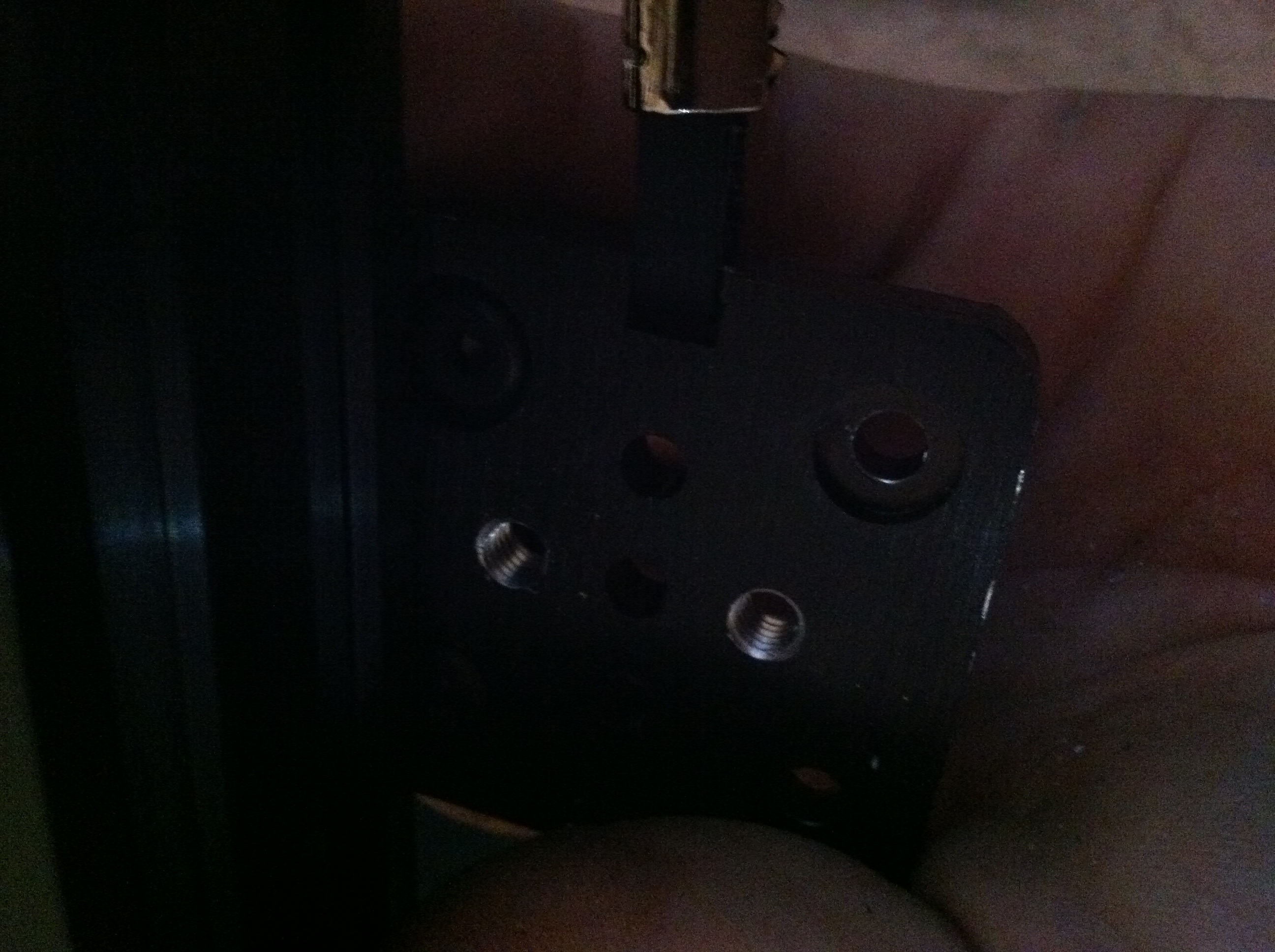

Tapped out the holes to 6MM X 1.0

Wiring up the heated bed. I grounded the plate also.
Wiring plus spring loaded adjustment screws.
