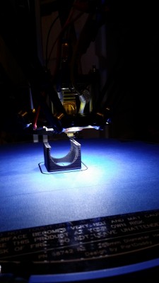

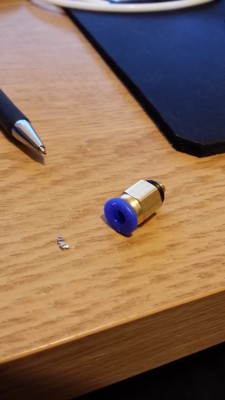

So I stayed up till 1am last night waiting for a print to finish (the fan shroud for my brand new E3D V5 extruder - YAY!) and so I was just watching a show and not watching the printer. Well... it evidently got to about 75% and the PTC fitting at the EZStruder decided to let go. When I later looked at the bowden tube, it looks like there was a defect in the connector as there was only 3 little points where the metal was holding it (the metal piece also fell out of the fitting). It wasn't a complete ring holding onto the tube. I guess I'd just been lucky up to this point. I thought maybe the hot end jammed, but I pushed on the filament by hand and it pushed easy as pie.
I took a picture of the tube having come detached and then the filament just looping in the air beside the EZStruder, but for some reason it turned out like I was taking a picture of bigfoot. Super blurry.
Filament sputtered out and was printing dry in the air for about 1/4" (probably 20 minutes)

The culprit!  This was the only metal piece inside the connector

TinyHead, looks like you have the old connectors. Those teeth will always eventually fatigue and fail. Get the new connectors from SeeMeCNC, they are amazing.
