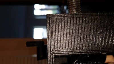

Not sure what's going on, but my prints have been awful lately... anyone tell me what's wrong? I've just recalibrated the bed, re-measured the filament, tightened the belts.
[img]http://i.imgur.com/6HnywN2.jpg[/img]
Filament is Filamex, purchased from faveprices on Ebay. Temps: 195c Noz, 60c Bed. Printing 100% speed at 35mm/s... safe settings. Sliced using Cura.

looks like you are too high off the bed on your first layer. increacse z height .25mm and try again. post results please...

If you've changed filament, run the extruder calibration and check the filament diameter.

Extruder calibration? Do you mean the E-steps? I did calibrate the endstop heights, and horizontal radius, and checked the filament diameter. I spent yesterday trying to tweak and test. I ran a print, which came out fine for the most part, just some typical problems with overhangs that I would expect... but I still see the problem mentioned above.
The print was small and with white filament, so it's not as obvious...but it seems like whenever I have to print straight lines the issue occurs, also, the same gaps in the infill at edges.

I think Foshon is referring to the filament diameter & extrusion multiplier settings in your slicer. If the slicer thinks your filament is thicker than it really is, your resulting gcode won't extrude enough filament, making the each extruded line too narrow. That's one possible explanation for the gaps you're getting.
Another way to make that bottom layer have wider lines is to get the nozzle closer to the bed so the plastic is more squashed against the surface as DavidF suggested.

But both of these issues I've addressed. I've re-calculated the filament diameter about 5 times now, and re-calibrated the height / bed about 3 times. I wonder if it's more an issue with it not being fed properly at times. Maybe the extruder gear slipping, or too much force being needed to pull the filament from the spool?
