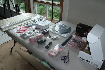

Here are some pics of my build. It went together well with no problems except a faulty hobbed gear . see that post here http://forum.seemecnc.com/viewtopic.php?f=37&t=6373
I had a lot of fun building it learned quite a bit.
everything laid out, counted and ready to build

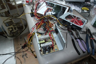

Cleaning up the excess wiring

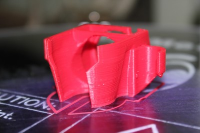

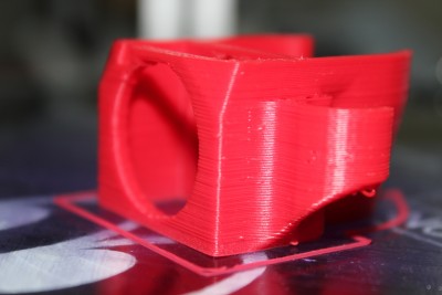

Some careful calibration and adding some PEI pays off. Check out the level of adhesion and how close I can get to the edge. This is ABS at 225 with the bed at 85.
2nd print - fan slid right in nice and snug

Very nice! Congrats on the build. Any separation on that large an ABS print?

Holy1 wrote:Here are some pics of my build. It went together well with no problems.
Very nicely built machine and you attacked the power supply as well, got to be the way it's done. Wiring looks really neat too :)

Tinyhead wrote:Very nice! Congrats on the build. Any separation on that large an ABS print?
No separation.I had an enclosure around it (except for a quick pic).
