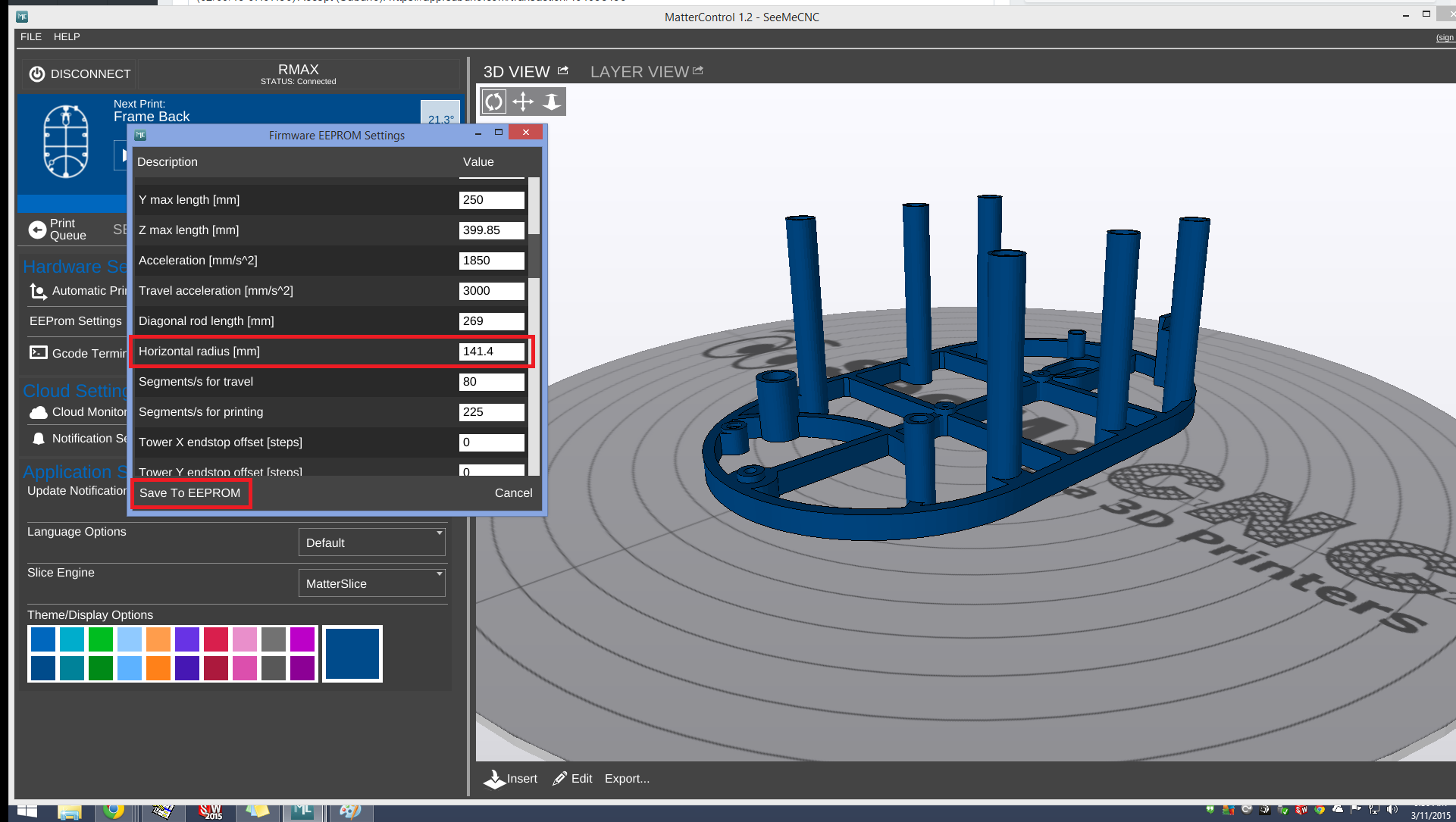

After about or year or so of printing , I decided to give it a nice overhaul on cleaning , came out nice looks new again , I remove the glass for some deep cleaning and when calibrating the bed levelness , I cant find the configuration.h after searching and running search its doesnt exist anymore.
So my problem is I need to adjust the printer_radius little bit , But now I have original repetier.ino and configuration.h files/script. So I am trying to save the time in re-doing all of it as I have no problems other the the center being off concave a little.

If you're using the .91 or greater firmware, that setting is available in the EEPROM table and you don't need to recompile to change it. If you don't have .91 or greater installed, then you probably should. :)

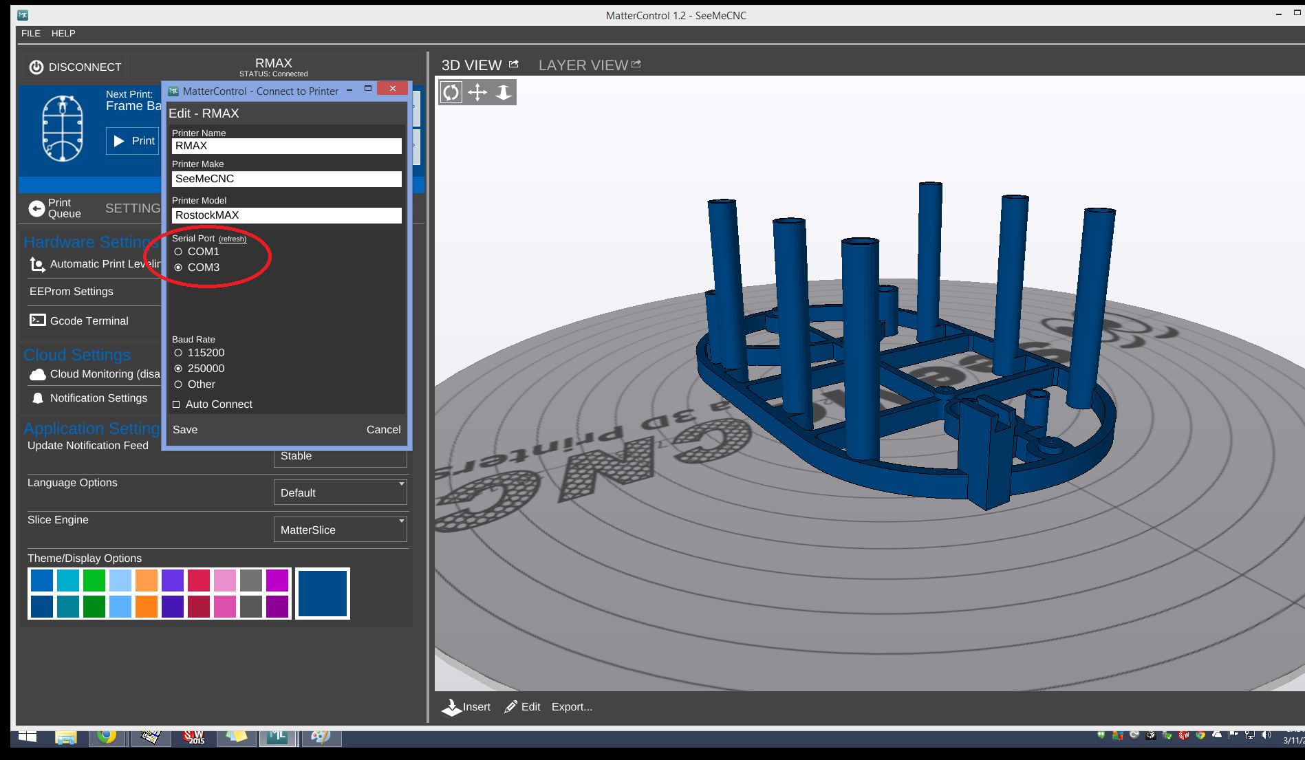

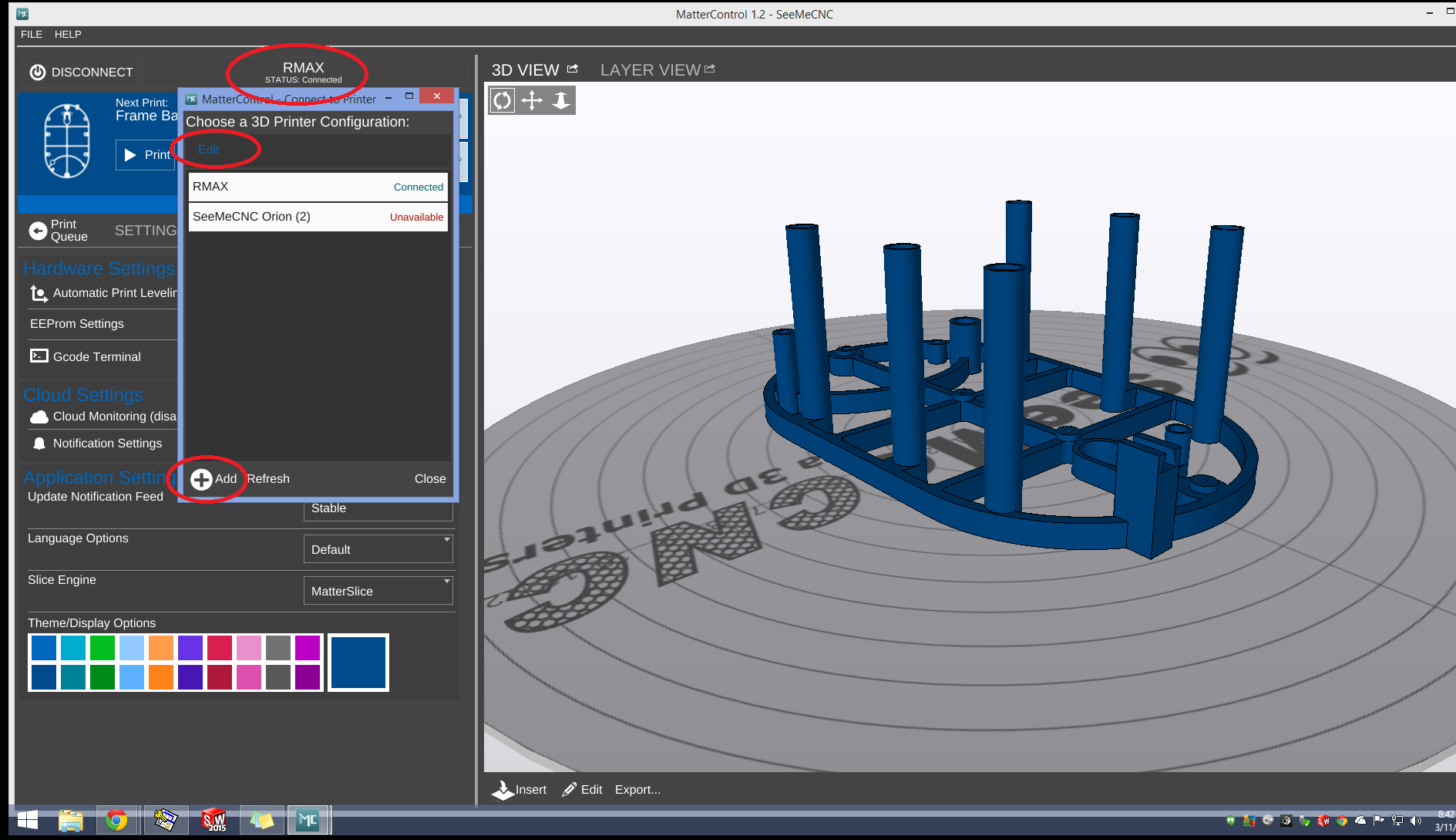

2. After installing MatterControl, setup your printer
define printer in
define printer in
3. Choose the COM port & make sure the baud settings are 250,000
COM setting
COM setting

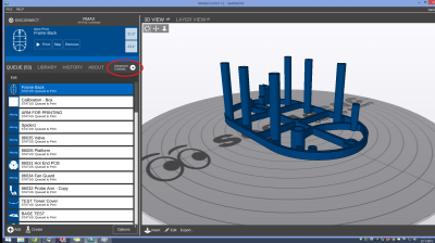

5. Once connected, click 'advanced controls' (see below)
advanced controls
advanced controls

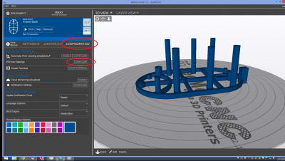

6. Select configuration then EEProm settings
config eeprom
config eeprom
7. scroll down to horizontal radius and enter a new value & click save to eeprom
horz radius eeprom setting
8. home the printer and run the calibration scripts again to check results.
Usually it takes a couple of trys to get it right.

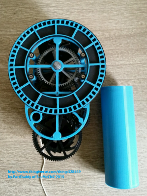

I'm taking the easy way out first. Then the mechanical engineer in me will print the planetary gear set once everything runs smooth. The MAX behind my desk was buzzing through these files in December while I was working on Eris molds. Sorry, I don't have the hands on it in this photo. I used steel pins lying around the shop for axles. Right now, it runs 30 seconds and hangs because of some first layer squishing on a few gears. We've been super busy at the shop, so it's been an on-off project with my son in the evenings.
