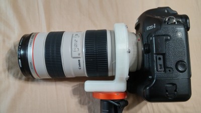

So an update: This stuff is STRONG when printed solid! I even goofed a part as I can not remove the supports from it as they are just stuck on too well even with the little contact they have. I can rework the part in CAD to get rid of the need for supports. But this stuff is doing great as a bearing for my project and helping me move ahead much faster than I expected. The 260 print temp seems to have been the right choice. 245 and it was just not bonding well at all.
I need to order more of this 910 as the client loves the parts and wants a ton of them.

OK so I have spent a bit of time with the 910 alloy now and I used it on a really important project I had and it blew me away! I needed to replace a bearing on a camera to lens mount. We wear the bearing out like crazy and Canon charges over $400 to replace them and I have to do it a few times a year. I had been searching high and low for a way to fix it and what to use filament wise. The 910 has proven to be a SUPER tough filament when printed solid and it is SLICK SLICK SLICK when it glides on more 910. This part replaced a full metal part and I beat the heck out of it shooting out in Cali this past weekend. The bearing is never this smooth and fast even when it first comes back from Canon. After a full weekend of being abused and twisted countless times, the bearing surfaces look brand new. For me this stuff is a lifesaver and is going to save me and my 100+ sports shooters that work for me a TON of cash Vs replacing the Canon bearing over and over throughout the year as we cover our assignments. The final bearing will be milled from 5083 aluminum tool plate with 910 nylon inserts for the bearing faces. In my book and for my project, 910 is a total winner!
I printed it at 260 on a 60 bed and at 90mm/m with a 3mm raft
Only word of caution I would have is watch out in supports and stuff. The 910 does NOT like to turn lose once it bonds so removing supports and such can take some work.
I also found the 910 to be very workable on the CNC mill and with a dremel after printing. I personally have found my new favorite filament for projects of this type which need toughness and ease of printing.
The gen 1 BETA tester mount. This thing was a DREAM to shoot with!
