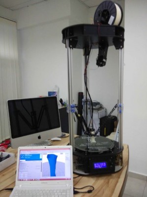

It's 3 weeks already and finally the build is completed. Managed to print the peek and layer fan holders. Glitches along the way.
1. Inverted the top section base plate. Somehow I messed up the left and right. Power and end stop cables crossed. So had to do some re-routing of the cables to separate the power and end stop cables. Thanks to teoman for advise on cables
2. Difficult to install the sprocket (manual adjust) for the extruder stepper motor. Had to widen the hole abit.
3. HAHA did not remove the paper to the melamin board, before building, for the bottom plates. So now slowly but surely removing it bit by bit.
4. Acrylic sheet, yet to install. Can we bend it that much? It won't break??
5. Getting the print out to stick to the base, finally got it with using ABS juice. I could not buy the Elmer glue.
ANYWAY SEEMECNC very happy with the purchase. NO issues with parts missing, parts cannot join, and definitely a wonderful BUILDING manual. A little confusion though, with the bottom plates.

May be the manual should include removing paper before start building. 8-) 8-) DIY nerd
The completed build
My Build
My Build

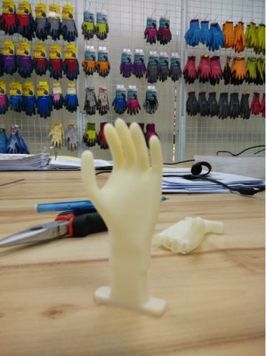

First print
Second
Third
Mini Hand. Bahind is failed print. Base not stick well. Behind behind are the home and garden gloves manufactured by us

Looks great! The layer fan shroud you printed was the wrong one - that one is for the older v1 effector platform. You want this one: http://repables.com/r/212/

OK, but will not fix the layer fans, most likely will run only ABS material for now. I did not try to install it so I was not aware it was the wrong one. TQ
