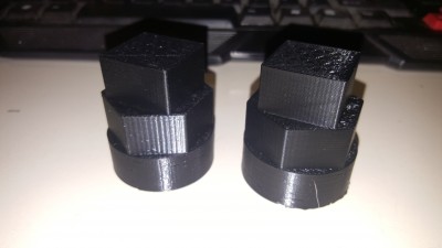

So I followed KAS's footsteps and installed 0.9 steppers with 16T pulleys, yadda yadda yadda, printed the bandaid model he used (before and after), using the same gcode off the sd card to eliminate any change in the print settings.
1.8 & 20T on left 0.9 & 16T on right.
Heres where it gets weird.
I went to recalibrate it using openDACT and was fighting getting it to do anything. Reset eeprom, reset eeprom, etc etc. tried to do a couple prints and every time it would rapid travel after homing and would get to about z 40.0 to z 1.00 and it would stop, and the lcd (staying lit) would go to the splash screen of (rostock max etc etc) before going back to the home screen.
I thought i was overdrawing maybe? checked and tried different current values, no change. i could traverse it up and down manually just fine. but when it tries to rapid travel, I think the drivers can't keep up with what it's trying to do. I messed with "non print speed" and "travel segments" and got it to start a print finally, and it would continue just fine. but that first initial plunge always causes problems. and it would do this when trying to run the opendact auto calibration.
I suppose I will try going to 1/8 microstepping and see if thats it, otherwise, you guys have any ideas?

left is 40mm/s, Right started at 150mm/s. at the first noticeable band in the middle I increased 150%. Just above that is the next band that was increased 200%.
You can definity see the rounding of the corners at higher speeds.
Right side top looks horrible with 3 layers, probably need to increase the temp.
