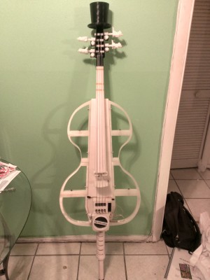

briankb wrote:I know I'm gonna get beat for this -- but I do not see using a delta configuration for high tolerance work.
Just felt like I should put my 2 cents in about what can be achieved with the accuracy and size of our particular delta machines.
I just finished my 2nd iteration of my cello today. This one is electric, includes a small class D amplifier and a speaker with a pre-amped, piezo-electric pickup.
Quite a few parts that require decently tight tolerances, such as the tuning pegs up top, and the battery compartment just above the fine tuner box.
Sounds pretty good in my opinion! I'll probably make a more comprehensive post about it in the "What are YOU making?" forum later.

That is amazing! Obviously, I just haven't found my groove with a delta yet.

Beautiful work.
And you demonstrate an important point: how accurate is accurate? How precise is precise?
A peg in a hole for an instrument string needs to be accurate to within about 0.2mm if tapered, maybe 0.1mm if it's straight through. The plastic deforms a little to take up the slack and so on. Inserting a sliding fit metal piston or dowel in a metal block needs something closer to 0.02mm to be right.
Horses for courses, and for an awful lot of courses (just like cast metal in my earlier analogy) the 3d printer horse is just fine.
