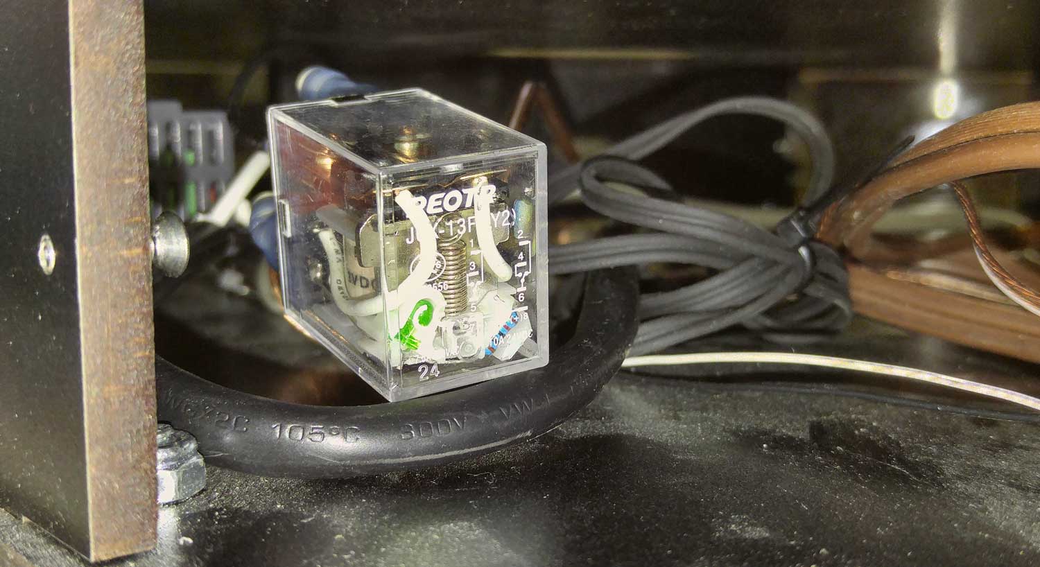

Completed item #5 noted in the original post.
Upgraded to an E3D Cyclops print head, and followed installation advice to connect cooling block fan directly to system 12V power.
> This meant the PEEK fan circuit was now available for other uses.
> So I set PEEK fan circuit to shut off (when the print head is cooling down) to 100C and connected this to a relay.
> Relay is rated to be switched by 3 to 15VDC power and switch circuits up to 240V.
> This relay now reliably and automatically shuts off the enclosure heat lamp about 5 minutes after the print head heat is switched off.
The PEEK fan circuit comes on, and stays on continuously, as long as the print head heater is activated. Temperature setting for PEEK fan circuit only comes into play after print head is no longer powered and is cooling down. Had to increase this well above its original setting of 53C as the enclosure heat lamp would frequently keep the print head above this temperature. Setting it to 100C as noted above assures that the enclosure heat lamp will shut down.
